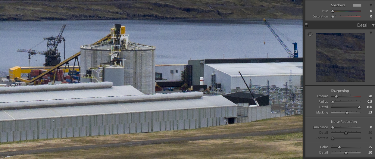

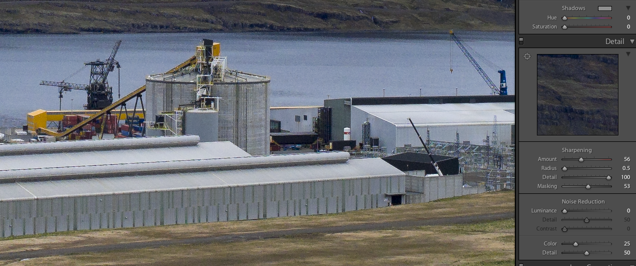

  • #970
    madmanchan
    You can use high Detail amounts (even 100) with S2 files, but please do so carefully. High Detail means ACR/Lr will do its best to extract every ounce of detail & texture available in the file. This is almost always undesirable for portraits or perhaps even general-purpose use where a smoother result is preferred. But for extremely fine detail (pixel-sized features like blades of grass, twigs, leaves, etc.) and texture + low ISO cases, a high Detail setting can be appropriate and highly effective. For such scenarios I also suggest reducing the Radius setting from its default value of 1, to something like 0.5 or 0.6.
    Eric Chan
    Camera Raw Engineer
  • #972
    madmanchan;732 wrote: You can use high Detail amounts (even 100) with S2 files, but please do so carefully. High Detail means ACR/Lr will do its best to extract every ounce of detail & texture available in the file. This is almost always undesirable for portraits or perhaps even general-purpose use where a smoother result is preferred. But for extremely fine detail (pixel-sized features like blades of grass, twigs, leaves, etc.) and texture + low ISO cases, a high Detail setting can be appropriate and highly effective. For such scenarios I also suggest reducing the Radius setting from its default value of 1, to something like 0.5 or 0.6.
    Eric Chan
    Camera Raw Engineer
    Eric,
    Welcome to Red Dot Forum and thanks so much for posting!
    I am curious about the relationship between radius and sharpening amount. For high detail scenarios, where you suggest reducing the radius to 0.5 or 0.6 (I use 0.8 by default), would you turn up the sharpening amount as well?
    Thanks again for chiming in.
  • #973
    madmanchan
    David Farkas;734 wrote: Eric,
    Not necessarily. I think of Amount as a “volume” control and hence it’s for seasoning to taste. In contrast, Radius and Detail are more for adapting the type of sharpening to the scene content.
