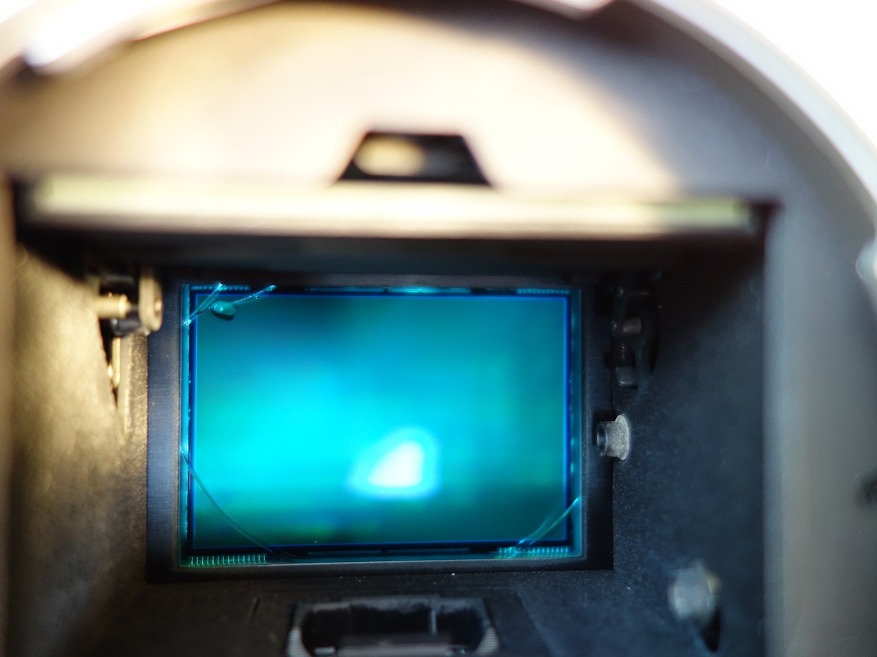

    veerachai
    Hello Andy
    You are the expert in S2 problem, may I ask you to see the attached picture whether this is considering as sensor filter cracked? I rarely use the S2 as I was busy with some certain project in the past year but beginning of Mar 2013 I took it out to show to my friend and after several shots, I found the picture was in a circle. After taking out the lens and lock the mirror up, I found the crack.
    Thanks for your answer.
    Veerachai
  • #3754
    Yes, that is a cracked sensor. The camera needs to go to Leica for repair. The good news is that the repair will be covered under warranty, and they’ll do a full “clean and check” of the camera while they have it.
  • #3756

    Dear Josh
    Thanks for your answer, I was wondering whether it’s still under warranty as I bought S2 since Sep 2010.
    Thank you.
    Veerachai
  • #3758
    Because the sensor cracking issue is a known manufacturer defect, it will be a free repair for the lifetime of the camera (or at least as long as parts are available) so Leica will repair the cracked sensor free of charge even if the camera is out of warranty.
  • #3759
    veerachai
    Dear Josh
    Thank you very much for your answer. I will get in touch with Soelm to send the camera back.
    Best regards
    Veerachai
