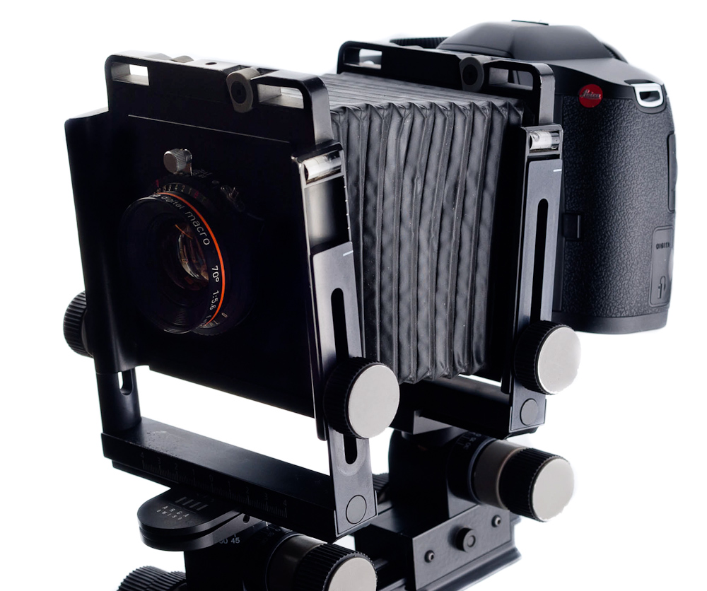

How well does this work? A little bit of tilt could solve some of the foreground to main subject depth of field problems I have been having. Granted I wouldn’t want to tote that rig around all the time.
- June 10, 2011 at 2:28 am #384David FarkasNewbieHollywood, FLJoin Date: Aug 2014Posts: 414Currently using:
Leica M, Leica S, Leica SL, Leica CLOfflineMark Gowin;34 wrote: How well does this work? A little bit of tilt could solve some of the foreground to main subject depth of field problems I have been having. Granted I wouldn’t want to tote that rig around all the time.

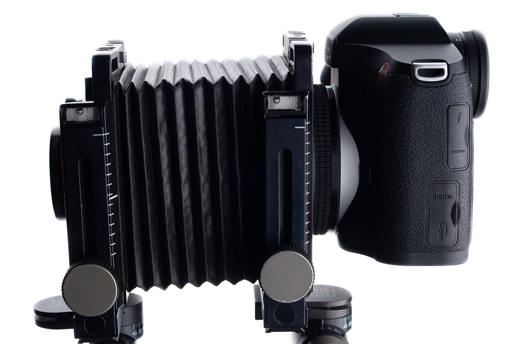

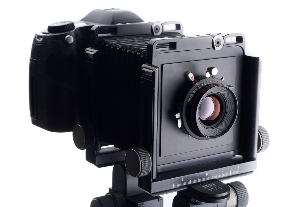

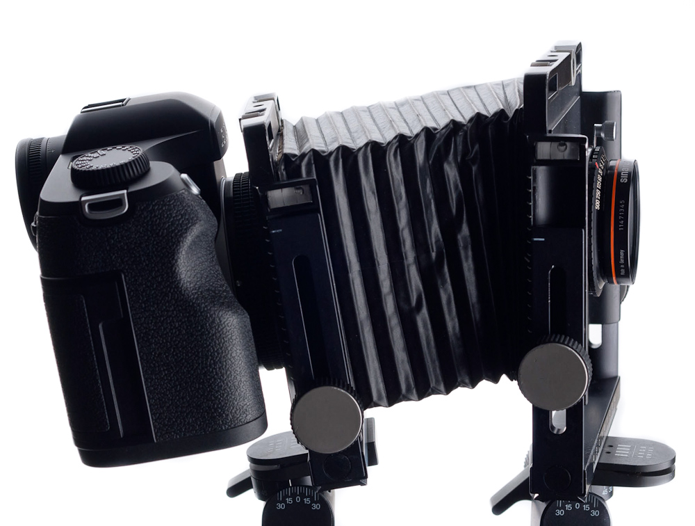

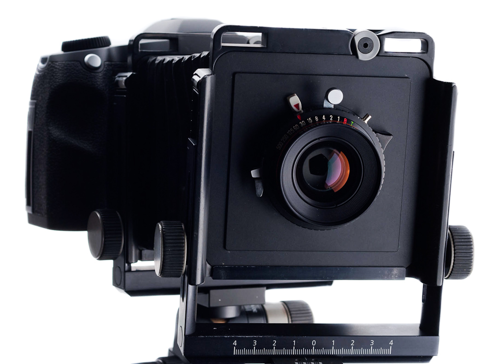

It actually works very well. Note that the lens mounted here is a Scheider APO Macro 120mm. Because of the increased register distance (both from the adapter board depth as well as the depth of the mirror box) vs a digital back or sheet film, wide angle lenses don’t achieve infinity focus. We are looking into a recessed lensboard and/or a shorter adapter tube to be able to use wider lenses.
And, this Arca Swiss has a folding rail and disassembles/reassembles pretty easily. Taken apart, it is actually pretty portable. And the lenses are tiny.

Just some questions out of curiosity, David…what is the widest lens you can focus to infinity with using this kind of setup? I suppose it would support basically any 4×5 lens as long as it was not too huge…
How do you synchronise the shutters in the S2 and the view camera? Just with a flash sync or something similar? Or do you have to use a dual cable release, or even use bulb on the S2 and then trigger the lens shutter? - September 8, 2011 at 11:11 pm #917David FarkasNewbieHollywood, FLJoin Date: Aug 2014Posts: 414Currently using:
Leica M, Leica S, Leica SL, Leica CLOfflineStuart Richardson;668 wrote: Just some questions out of curiosity, David…what is the widest lens you can focus to infinity with using this kind of setup? I suppose it would support basically any 4×5 lens as long as it was not too huge…
How do you synchronise the shutters in the S2 and the view camera? Just with a flash sync or something similar? Or do you have to use a dual cable release, or even use bulb on the S2 and then trigger the lens shutter?Stuart,
We are currently experimenting to see what the widest usable lens is. We have a 15mm recessed lens board and a wide-angle bag bellows (both different than what is pictured here). Both of these have given us an extra 20mm or so, but we are exploring other avenues to reduce the register distance further. We will publish our final findings and some test shots soon.
As far as the shutter goes…. the S2 uses a focal plane shutter, so we just leave the lens shutter open. There is no reason to sync it. Same goes for using Hasselblad CF lenses.
