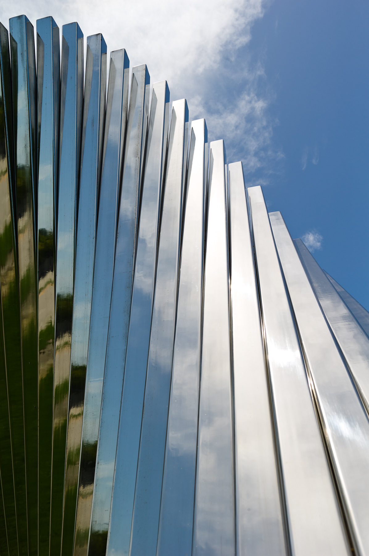

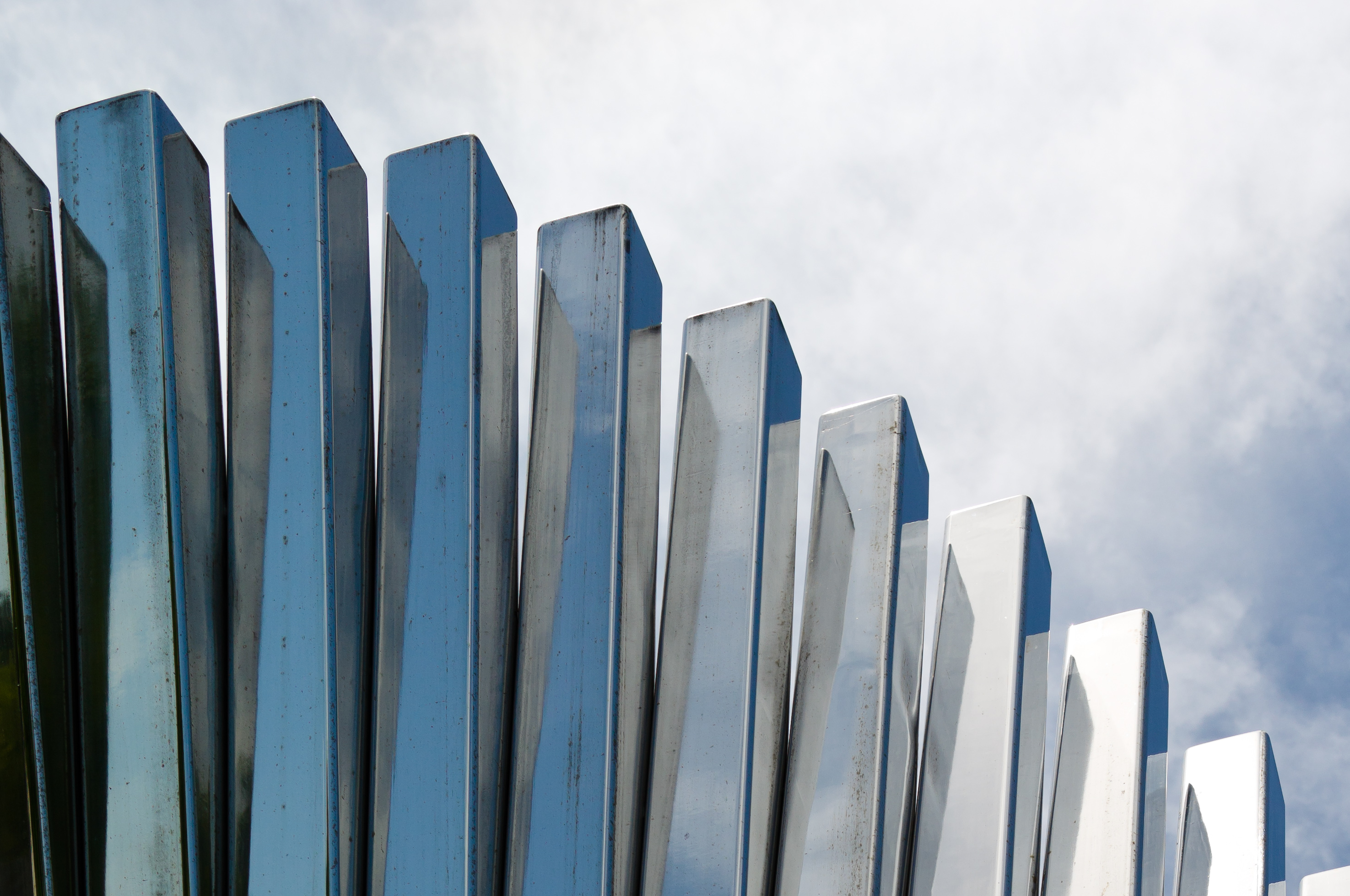

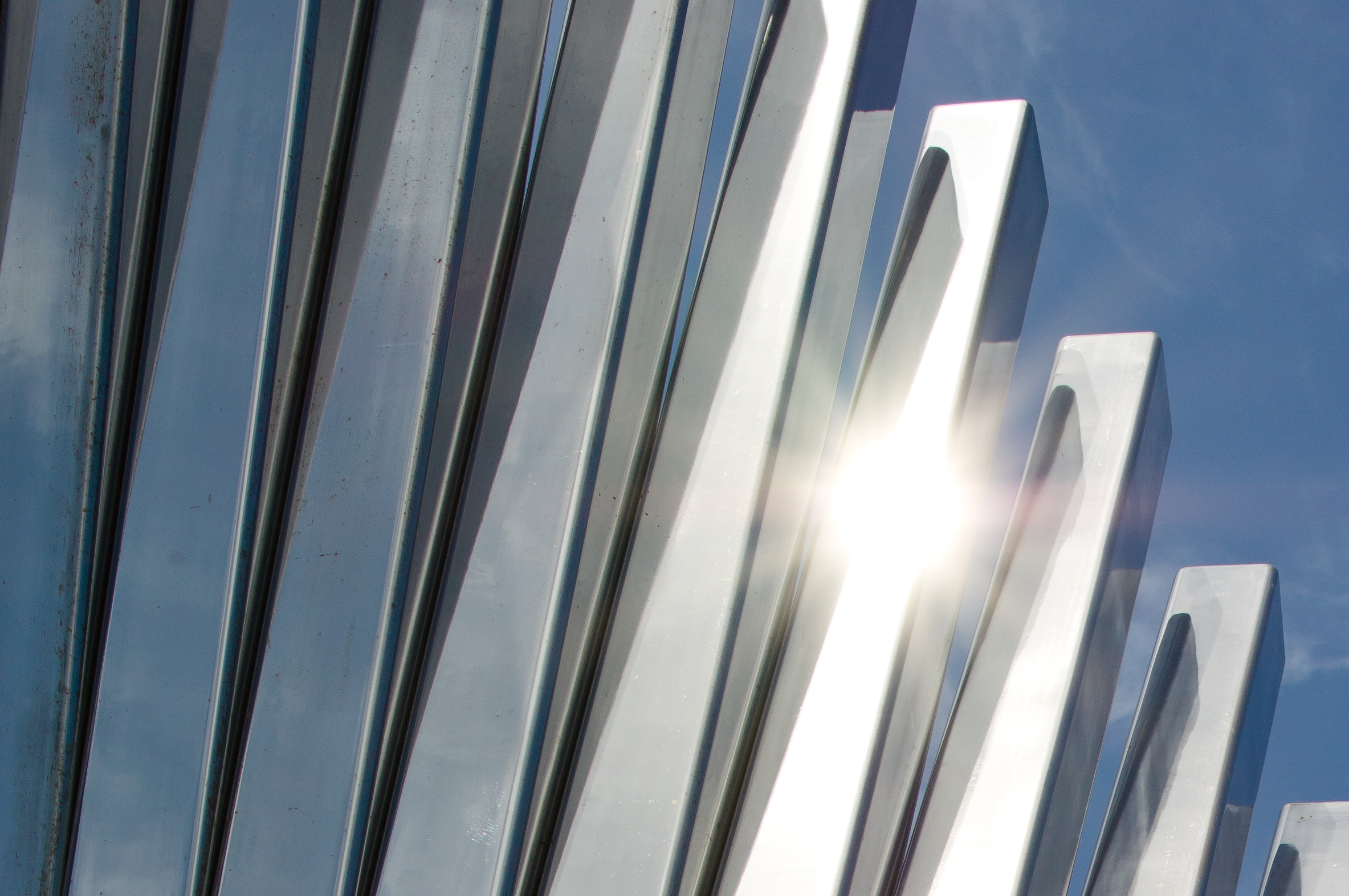

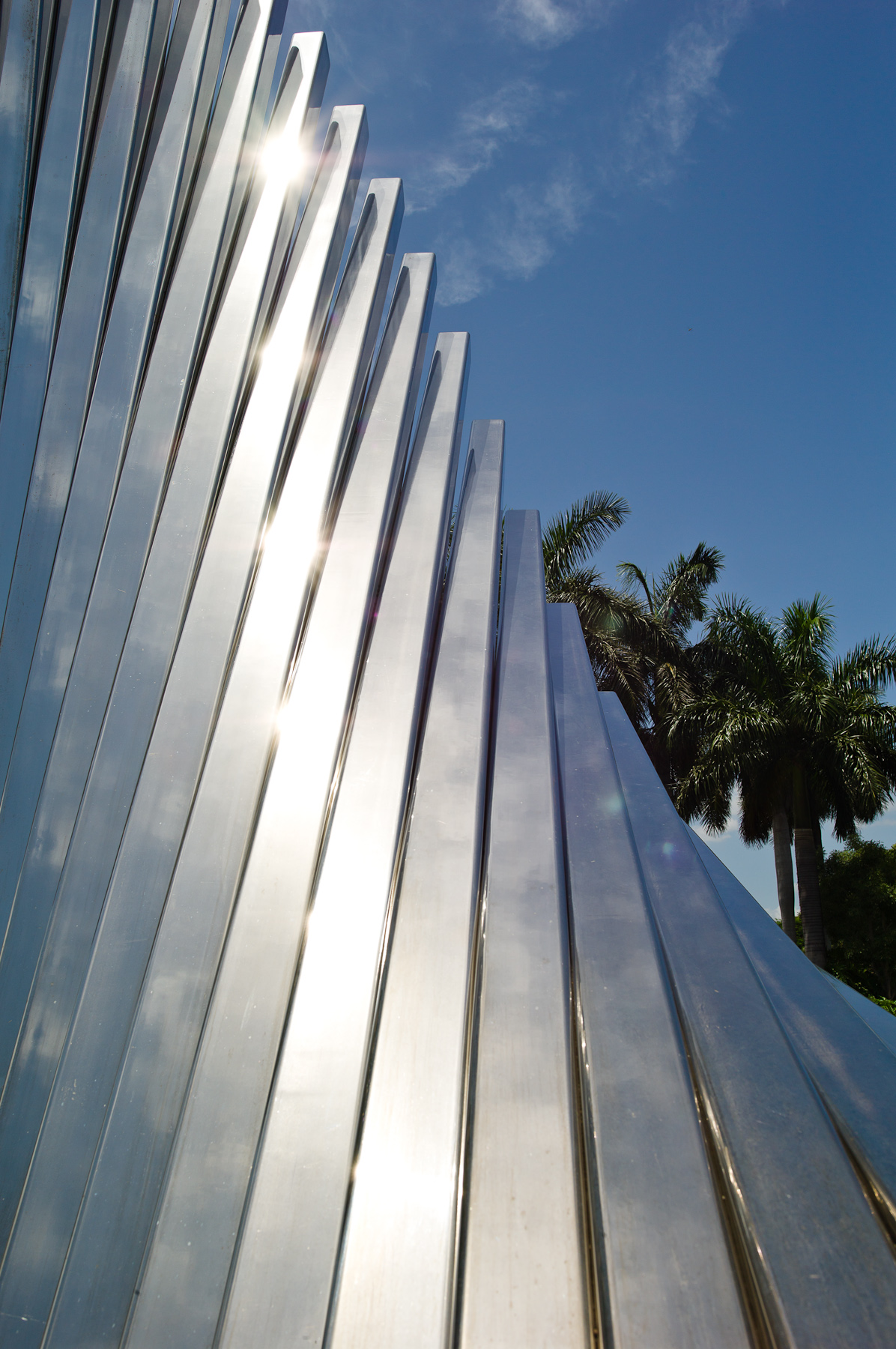

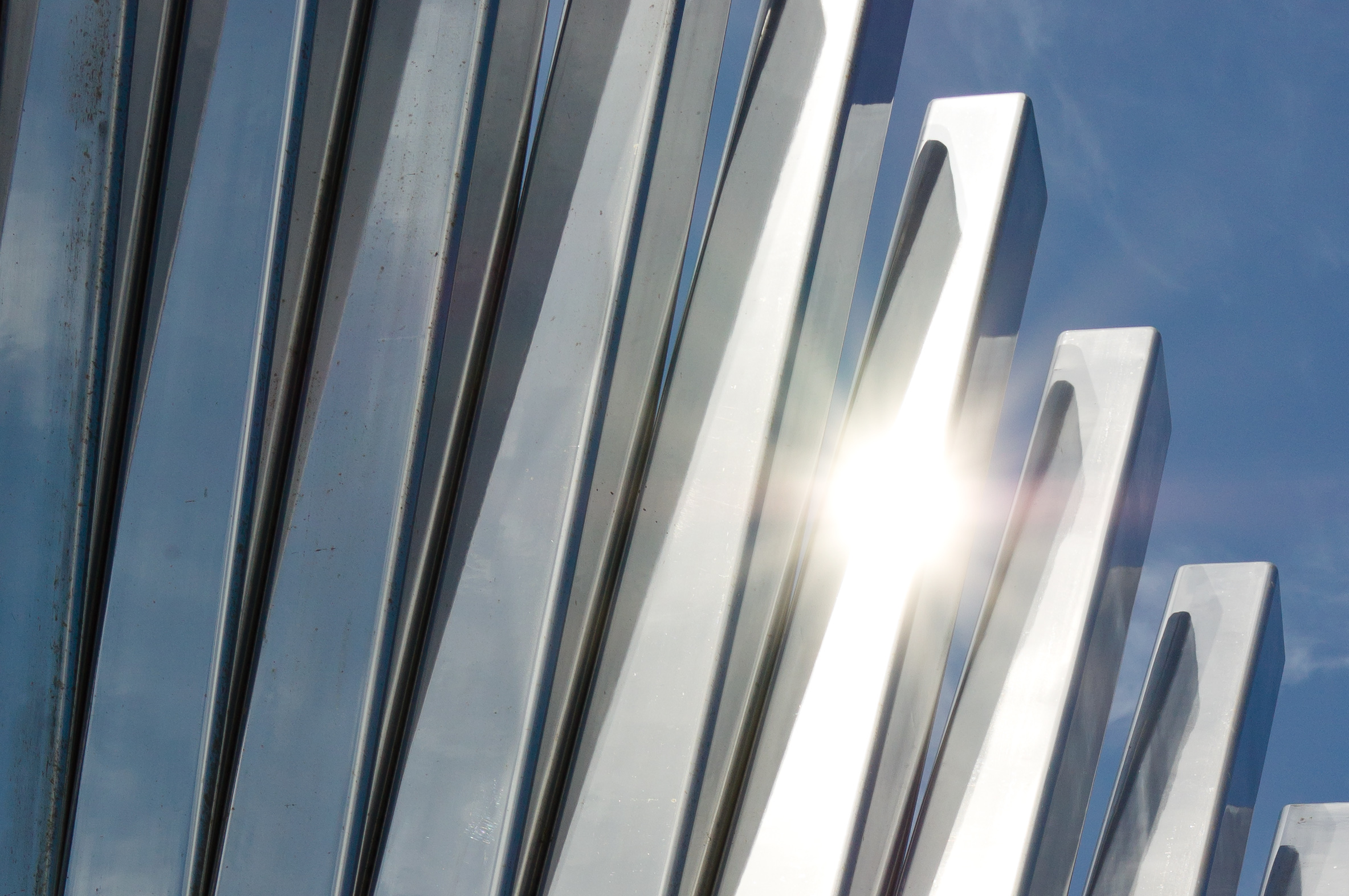

Ask and you shall receive. I went out today with the S2 and 35mm Summarit-S around noon when the South Florida light is at its most harsh and direct. I headed for a polished stainless steel sculpture in nearby Greenbelt park as I figured it to be the toughest test of CA within driving distance.
The files here were processed in LR 3.4.1 with my standard S2 preset applied (which includes auto lens profile correction). I then unchecked the lens profile so that the shots are identically processed otherwise. I made no additional CA correction or moved the sliders in the lens profile tab from their default positions (100 for distortion, 100 for CA). For each set, the image with no lens profile is first and the one with lens profile applied is second.
The full shots when clicked will bring up 1800×1200 images sized down from the original. The crops when clicked are non resized crops and are pretty large. The thumbnails generated by the forum software don’t show much difference, so please make sure to click on each example.
Here’s the results of the tests:
First, the full shot with no lens profile applied
S2 with 35mm Summarit-S, 1/750th @ f/8, ISO 160Full shot with the lens profile applied
100% crop from upper-left corner with no lens profile
100% crop with lens profile
Another full shot with no lens profile applied
S2 with 35mm Summarit-S, 1/750th @ f/5.6 ISO 160Full shot with lens profile applied
All in all, a very strong showing from both the 35mm Summarit-S and the LR lens profile. What little CA is present in these extreme examples (at the frame edge I might add) is almost completely eliminated with one click.
