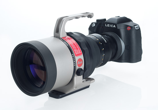

How fascinating! David, Will I have to do permanent changes to my APO-telyt or can I manage via an adapter?
Thanks for posting,
Arif - September 15, 2011 at 1:13 pm #950David FarkasNewbie
Arif;711 wrote: How fascinating! David, Will I have to do permanent changes to my APO-telyt or can I manage via an adapter?
Thanks for posting,
ArifArif,
I’ll post all the details in my article, but no, this isn’t done via an adapter. The lens has to be shortened to achieve infinity focus. This also involves moving the aperture ring and mechanical linkage back towards the front of the lens. Because of this, I don’t think the 1x module will work, only the 1.4x and 2x.
If you are interested in converting your lens, let me know.

Should we assume the larger lens head would work too?
- September 16, 2011 at 12:44 am #957David FarkasNewbie
Doug Herr;718 wrote: Should we assume the larger lens head would work too?
Doug,
I would assume so, as the image circle limitation comes from the focus module not the lens head.
With the larger 400/560/800 lens head and the 1.4x, you’d have a drool-worthy 560mm f/4 on the S2!! 😎 This is equivalent to a 450mm in 35mm land.

David Farkas;712 wrote: Arif,
Thanks for the reply. as luck would have it, I have the 1x so will wait and see if the 1.4x or 2x shows up as a bargain. I will wait for the details in your article.

Beautiful conversion of the lens. It would be an easy way for Leica to provide manual focus long glass in a short time, just convert the focus modules like you have. Aside from the fact that the 1x tube is too short, the 1.4x increases the image circle as well, yes? - September 3, 2015 at 5:33 pm #12982Boris MassieuxFrequent Member
FranceJoin Date: Sep 2015Posts: 3Currently using:
Leica M, Leica CompactOffline
Is it still possible to make this modification?
I have no 400 nor the module, but the results are amazing. - November 2, 2015 at 3:19 pm #13276
Solms modified my 1.4x tube to work with LeiKo adapter on the S series, I will probably send my 2x tube off next year, They have not done many and it is on the edge of what can be modified, and comes back with lots of disclaimers 😉
