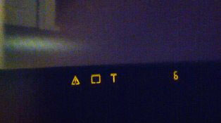

Leica M, Leica S, Leica CLOfflineI was doing some photography out of a float plane yesterday and was confused by the lack of seeing an f stop in the viewfinder half way through the shoot. Then I noticed that the focus button was not working. There was a blinking warning triangle I had never seen before. Yes, I had seen a warning triangle for exposure compensation, but not this blinking warning triangle. The photos were coming up fine, and I was shooting wide open anyway so I didn’t worry about the fact I couldn’t close down the f stop.
When I got out of the plane and back to land, I realized the problem. The lens change release button must have gotten pressed, because the tens was not seated properly. If it had continued to rotate during my focusing, it was highly likely that my 120mm would have fallen off the camera! Yes it is water resistant when attached to the camera, but not so much when falling 2,000 feet into water.
I suggest you all look through your viewfinder when the lens is released a bit of a turn so you get used to seeing what it looks like.

Being a new S2 owner, lots of stuff is new to me.
Friend this weekend loaned me his 35mm lens * big mistake, but thats another story * and when I put again my 70mm , this triangle appeared. Though it was the exposure comp triangle, but this blinked.
All was pretty much normal until I came to the forum to well, procastrinate a bit eheheh and saw this post. Went back to my S2 and was this / the lens was not correctly attached and not properly seated.
